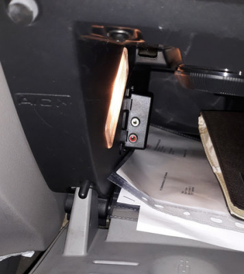

Hello,
I own Peugeot 308 SW from 2012. Car has RCA jack in glove box and no AUX input.
I am trying to connect USB to play music. I bought AUX to USB adapter and RCA to AUX cable.
When I connect USB, nothing happens. It shows no music on it.
Attached are photos of the cables and glove box connection.
Any ideas how to fix this?

This will not work, you can't add usb this way.

Is there a way I can add USB or connect my phone via bluetooth? I do have a bluetooth installed but it can only do calls. Does not play music

I can only recommend a 2 DIN car player with 2GB RAM, Bluetooth Module and USB interface.
This one fits perfect into a 308 and even steering controls will work:
https://a.aliexpress.com/_eKDTjP
But if you want use your original one, then you can add a Yatour Box or something like this.
The Installation ist pretty easy, by connecting the box to the CD changer slot. (You will have to activate the CD changer option via Lexia/PP2000 in the car electric.
https://a.aliexpress.com/_eNLZTf

So what are these RCA plugs for then? What can be plugged in there?

It's only for AUX.
https://www.amazon.de/BestPlug-Stecker- ... B003WPLJZK
USB will not work, USB Transfer is digital and it needs a Power supply. RCA can only Transfer linear.
